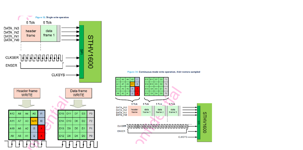

I am working on a QSPI project, the target device is STHV1600 from ST. the chip control is like QSPI, but I think need some customization.
If there is no QSPI IP core that I can use directly. is it possible to make some modification of a standard QSPI core? I hope it will save some time if there is someone already invented the wheel.
