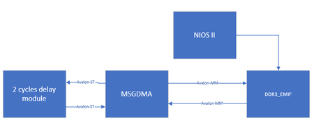

Hi, experts I have built a NIOS II system to verify MSGDMA. The structure is shown as below: The steps it works: NIOS write test pattern to some certain space in DDR3 NIOS configure MSGDMA...

6 years agoI come back to finish this , I solved this in a very simple way, that is , set the msgdma data fifo depth larger !
