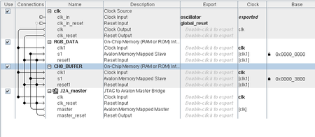

Qsys On-chip memory access
You don't need a license for this. Could the design be stuck in reset? You got 1 back from the jtag_debug_sample_reset command.
Yes. I did get 1 back from jtag_debug_sample_reset command
I have pasted commands and responses below.
% jtag_debug_sample_clock $jd_path
0
1
% jtag_debug_sample_reset $jd_path
1
% jtag_debug_reset_system $jd_path
1
% set m_path [lindex [get_service_paths master] 0]
/devices/10M50DA(.|ES)|10M50DC@1#USB-1/(link)/JTAG/(110:132 v1 #0)/phy_0/master
% set claim_path [claim_service master $m_path ""]
/channels/local/(lib)/master_1
% master_read_32 $claim_path 0 1
error: master_read_32: This transaction did not complete in 60 seconds. System Console is giving up.
while executing
"master_read_32 $claim_path 0 1"
