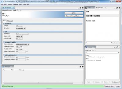

I’m trying to generate FFT 16.0 Core with QSYS. With the setting shown in the attached file the generated code can be synthesized. If I change Data Input Width and Twiddle Width to 32 Bit the .hex files will be generated wrong. fft_core_fft_ii_0_1n64sin.hex :03000000000000fd :030001000c8bd35c36 :0300020018f8b83cf7 As you can see fft_core_fft_ii_0_1n64sin.hex the length of the first doesn't match to the length of other lines. Output from Quartus: Error (113029): Data size does not match the number of bytes at line 2 in Hexadecimal (Intel-Format) File "fft_core_fft_ii_0_1n64sin.hex" How to fix this problem? Best regards Samuel1 Reply

The problem is still open. I attached the qsys files, the bug should easily be reproduced.
Thank you for your help
