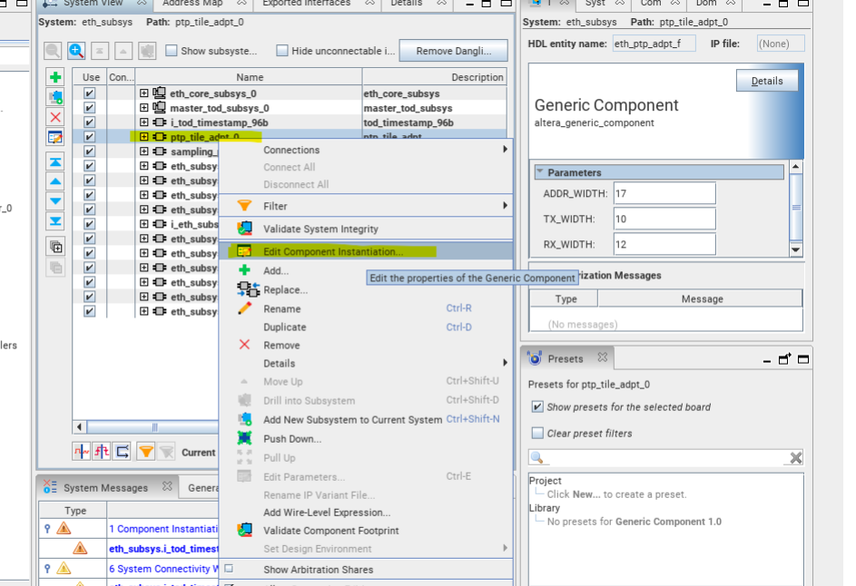

    If you right click the 'ptp' file in platform designer and click "Edit Component Instantiation" (screenshot below), you will see the source file is actually referring to the one located in ftile ethernet folder rather than the one located in custom ip folder. You can just delete the file since you are deleting the culprit which confuses Quartus.
