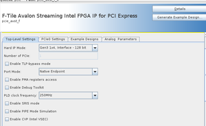

problem to use F-Tile Avalon® Streaming Intel® FPGA IP for PCI Express*
You can generate a PIO example design based on Gen3 1x16 first. Then go into that generated design, modify the PCIe to Gen3 1x4, and click "Generate HDL". After this, you can do a full compilation. I see no critical issue reported in this process.
Rong
But in the design of Gen3 1x16, the PIO module only supports 256 bit or 512 bit, while the bit width of Gen3 1x4 is 128 bit. I don't know how to use it when it's 128 bit.

- Geats_X1 year ago
So if I use the pio example design of gen3 1x16, I need to replace pio0 and mem0 modules with my own user logic. This will result in the error I explained, won't it? What I want to know is what user logic should include or at least include, so that those errors will not occur during compilation.
