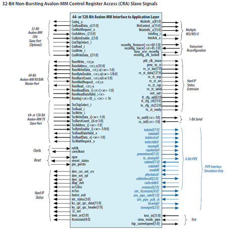

Dear community,
I'm confused about this figure from the ug_c5_pcie_avmm.pdf: What is depicted here? Are these the inputs and outputs of the (1) Avalon-MM CV Hard IP for PCI Express IP core or are ...
