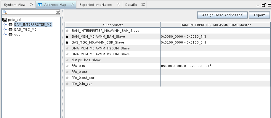

Platform designer AVMM address map log
HI Everyone,
I have a project made in platform designer and in address map tab I can see the address range assignments to various AVMM ports. I want to export this table as text or CSV format for documentation reasons. What is easiest way to export this address map into text based formats? Is there any Quartus log files from where I can copy this?
thanks
  • ShengN_altera's avatar
    ShengN_altera
    It can only be exported to .amap format.
    You can highlight the whole table and CTRL+C to copy the whole table then CTRL+V to paste in excel. After that, convert the excel to text.
    Or straight away pasting in text file.
    Sheng
  • sstrell's avatar
    sstrell
    What does the Export button there do then?
    ShengN_altera
    The export only can export to .amap format.
    Sheng
