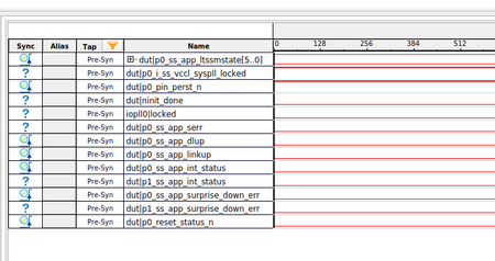

Hi Altera Team, I'm trying to get PCIe connection working on our custom board. We had some problems with our design. Reset pin (CF128) is connected to CF121 on board (we forgot to connect it). At th...

2 months agoThe problem was lock signal from IO Pll. Reset IP was holding core in reset. I have this clock figured out on my final design, but not on example.
My bad
I didn't expect this dependency
Problem solved
