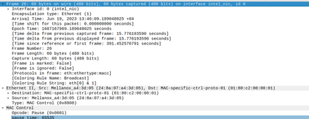

3 years agoPause packets are not processed on E-Tile Hard IP for Ethernet Intel FPGA IP
Hello. I work with AGFB014R24B2E2V device and use 100Gb E-Tile Hard IP for Ethernet Intel FPGA IP and I see that some of packets are dropped by the connection partner which is Mellanox board. I'v...

3 years agoIt seems that the problem was with destination mac address for rx pause packets. After adding code that writes the right address in IPs registers pause started to work.
The issue can be closed now.
