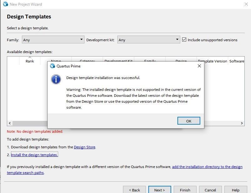

    As you share pervious post TSE Reference Design for Arria 10 . I try in Quartus 18.1 design I am getting warning below
    Nome

    I send the .qar file here. Hope that this triple speed ethernet example design is useful to you.
    zying

    You mentioned the Arria 10 Reference Design, which includes IP for XCVR, PHY, and other components. However, it does not support IP in the Arria II GX FPGA.
    If you happen to have a reference design for the Arria II GX with GXB transceivers, could you please share it with us?
