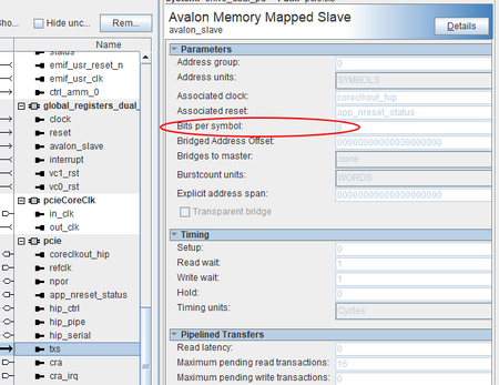

5 years agoMultiple questions: writing to PCIe TXS port with 64-bit addressing (Cyclone10GX)
I'm attempting to do DMA writes to the TXS port, with 64-bit addressing enabled. A SignalTap trace shows the bus transfers working fine, but data is not appearing in main memory (at least, not where...
- 5 years ago
- Yes, you are right. No translator is needed for 64 bit addressing.
- The TXS port, it is using byte addressing. If you set the address to 33, the memory size that you can access is 2^33 bytes. From the Platform designer, you will see the address range is from 0x0 to 0x1_ffff_ffff when the addressing width is 33 bits.
Regards -SK
