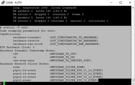

I am trying to make an implementation for PTP time synchronization using a DP83640 PH...
