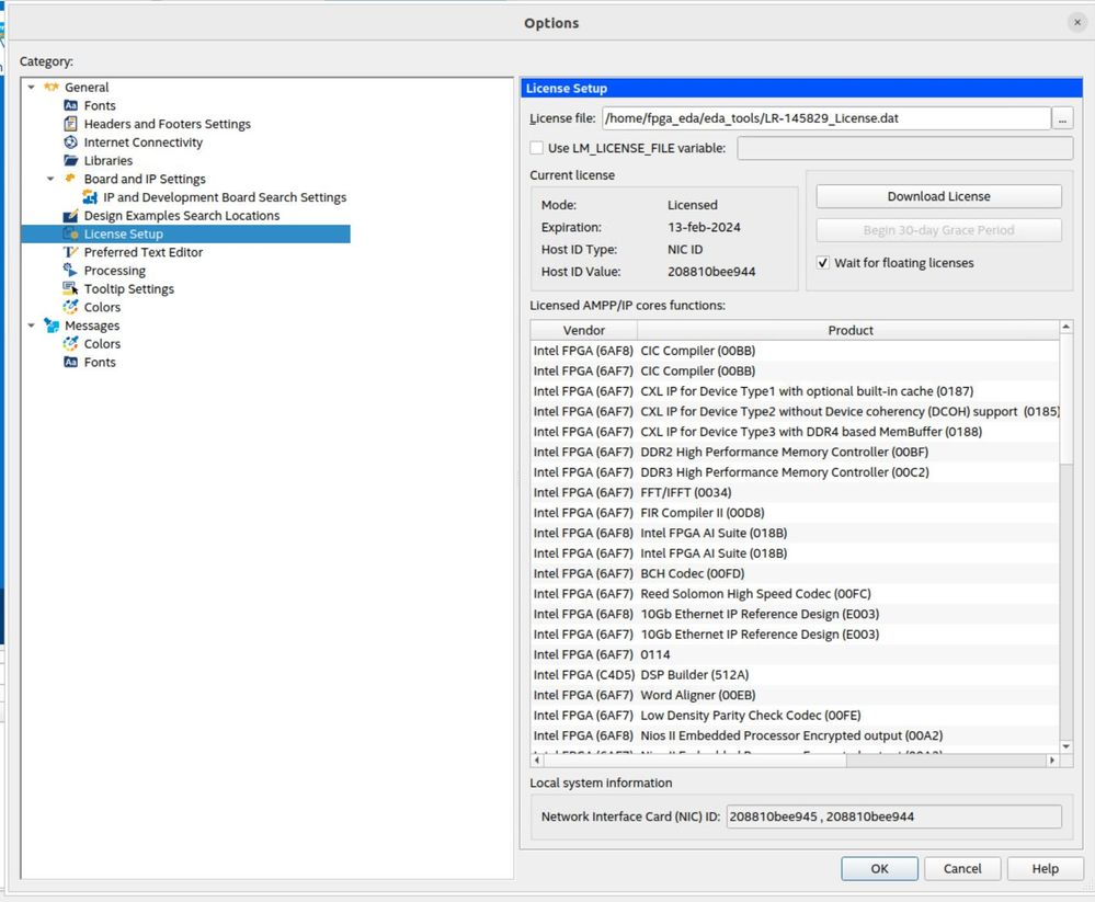

And the the license features for Quartus 23.3 are as the attached picture.

Hi
Could you help to regenerate again a new license.dat file in SSLC. Refer the steps here, Guide to generate license file. And try the new generate license, see how things go.
