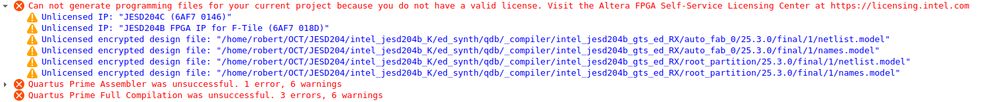

However, after making the changes and assigning the pins, I wanted to generate the final output file, but I encountered the following license error:

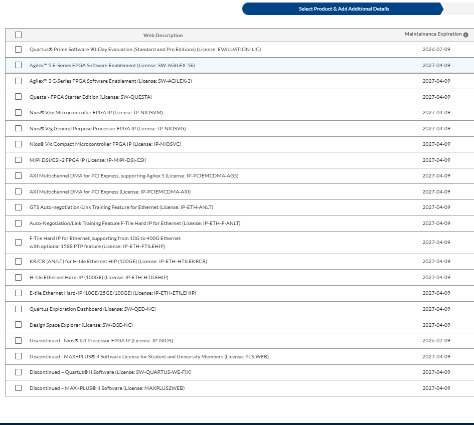

On the licensing page, I do not see any entry for JESD204B anywhere.

    Please use the Quartus Prime 90-Day Evaluation license. Then make sure enable the Altera FPGA IP Evaluation Mode under Assignments -> Settings -> Compilation Process Settings -> More Settings

    Based on the screenshot you shared, it appears that the JESD204B IP license may not be detected in your Quartus environment.
    Could you please help confirm whether the JESD204B‑specific IP license has been obtained after purchase and added to your Quartus license file? If the license has not yet been set up, please let me know and I’d be happy to engage our licensing expert to assist you with enabling the license.
