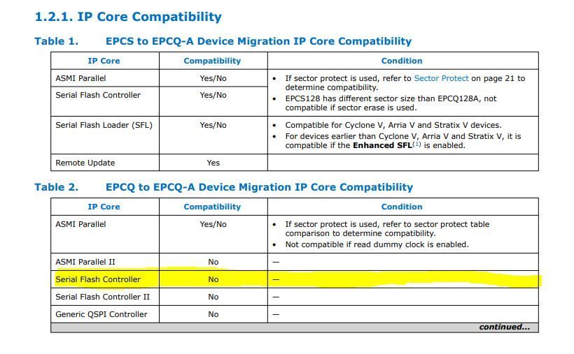

It is not possible to use EPCQ-A with Quartus 17.0.2 build. Plus, you are using ASMI Parallel II IP which not IP Compatibility.
https://www.intel.com/content/dam/www/programmable/us/en/pdfs/literature/an/an822.pdf
Therefore, you need to regenerate IP core and programming file.
However, if you use a legacy device that is not supported in the Intel Quartus® Prime software version 17.1 and later, the Quartus 13.1 Version have patches available to download which add EPCQ-A support to legacy Quartus releases.
https://www.intel.com/content/www/us/en/programmable/products/configuration-devices/support.html#software-download
