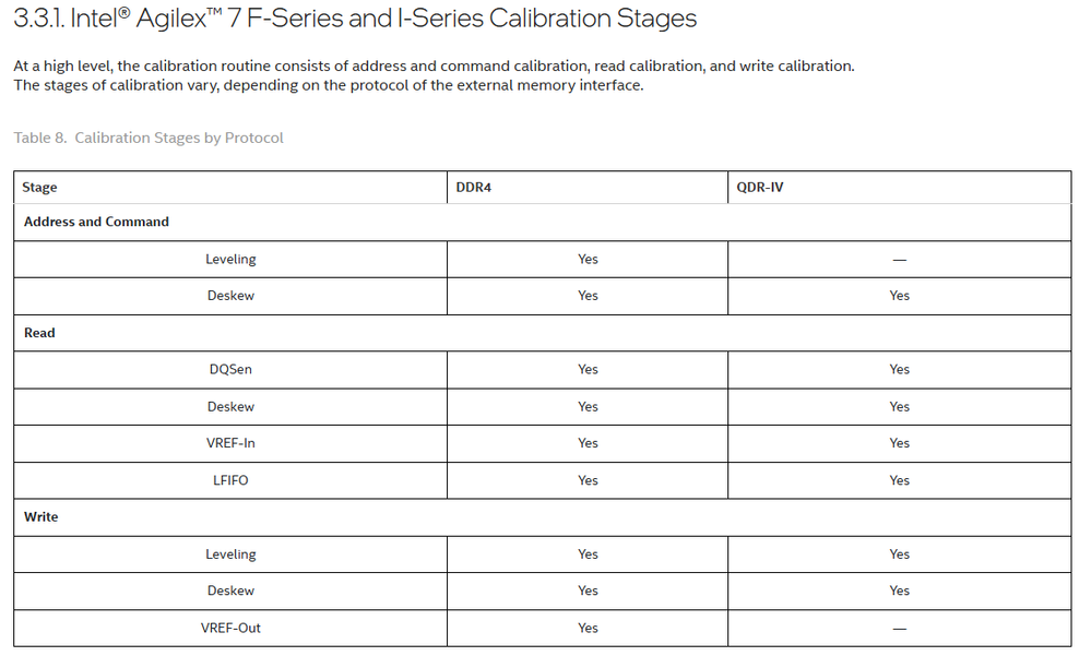

Is Agilex 5 DDR4 calibration support Command Bus training?
May I know if Agilex 5 DDR4 calibration support command bus training? This info is not in the Agilex 5 EMIF IP UG, but it is in the Agilex 7 EMIF IP UG. Can you confirm if Agilex 5 DDR4 support or not?
For your reference, below is the calibration stage for Agilex 7

    The address and command bus should be calibrated in Agilex 5 DDR4.
