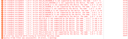

I am creating pin planning for Arria 10ax057,
i used 2A Bank for GPIO with 1.8V my compilation was successful.
in other requirement i have to use LVDS pins, so i removed few GPIO's and tak...
Rk_Athram
5 years agoThank you for reply.
as 2A bank is having configuration, and i used those as BIDIR . so it caused error.
when configuration pins ignored/taken as input to design the issue is solved.
