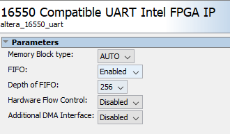

The IP core configuration is here:
Clock rate is 20.48 MHz.
