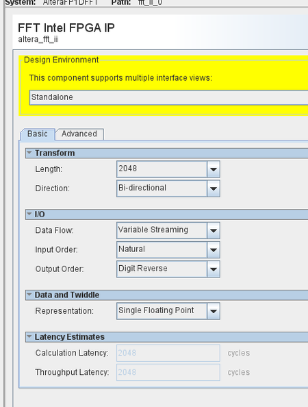

I have then taken two copies of the intel FFT core as configured in the post above; and I have set the "inverse" port of one of the instances to 0 and in the other instance it is set to 1. So I am expecting that one of the instances will calculate the FFT and one will calculate the IFFT.

However the Big Problem here is that no matter whether I drive the "inverse" port to 1 or 0, I am only getting the forward FFT and it never calculates an IFFT for me.
For clarity, the "inverse" port value is hard coded and a reset event happens at the beginning of the simulation for 5 clock cycles before data is sent to the core.
Does anyone have any ideas on what I might be doing wrong to configure the core to give me IFFTs?
