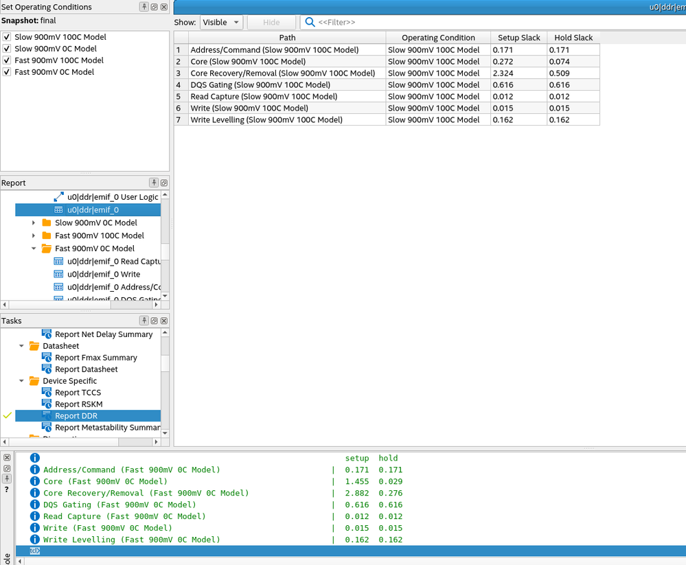

Please share the Report DDR as snapshot below after the compilation process.

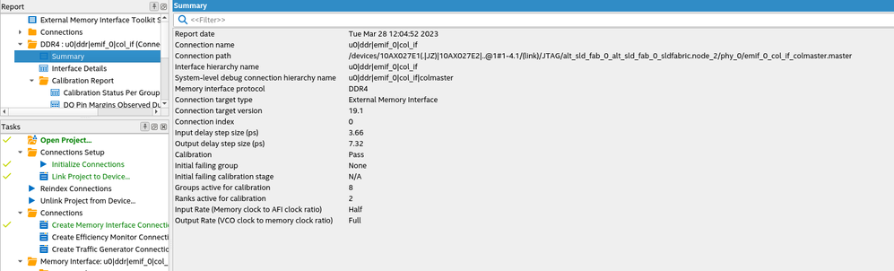

Hello Adzim,
I have tested example design from your project. EMIF IP settings are working on my board. All 6 same type RAMs from different vedors have passed calibration.
Also, I tried to increase working frequency up to 1200MHz and it was still working. It took me around 1 month to find a proper settings and your solution finally give me a required result.
