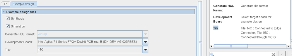

Inquiry about Development Kit Options and Device Model Compatibility for CXL Design Examples
When generating a CXL design example, the Development Kit options in the configuration menu only include DK-DEV-AGI027R1BES and DK-DEV-AGI027RBES, with DK-DEV-AGI027-RA not available. If I want to generate a design example corresponding to RA, should I select DK-DEV-AGI027RBES? I heard that DK-DEV-AGI027RBES is a test version, while DK-DEV-AGI027-RA is the production version. Additionally, if RBES is chosen, can the device model AGIB027R29A1E1VB corresponding to RA still be used?

    Hi there,
    Due to DK-DEV-AGI027-RA involve the device is AGIB027R29A1E1VB, and it is a earily version fpga. If u wanna use CXL ip on this device, quartus should roll back to 22.4.
