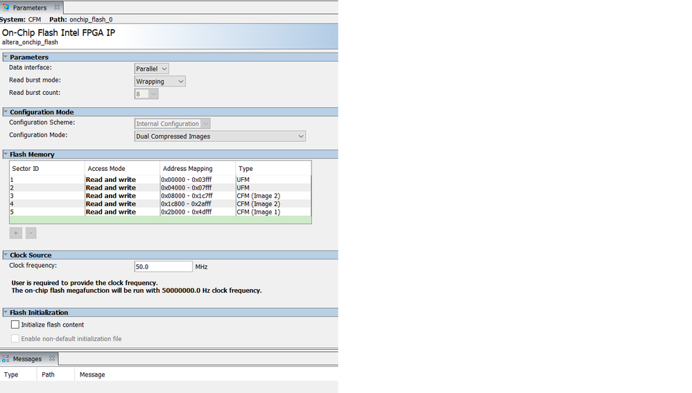

I want to Erase CFM0,but it seems like flash didn't response.
I want to Erase CFM0,but it seems like flash didn't receive my command. Why?

    1. May I know how do you connect the clk to the On Chip Flash IP?
    2. Is it from internal Oscillator or clk pin?
    3. What is the clk frequency used?
    4. Could you read the status register (CSR_ADDR = 0x0) after you disable the write protection and after you execute sector erased?
