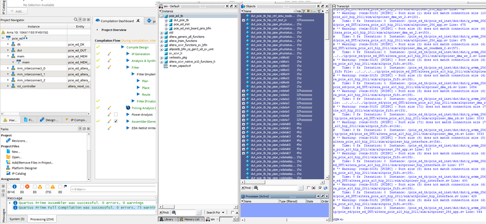

I start from create a pcie module from the Intel example. which can be complied and simulated by the platform designer created environment.

1. Is there a document explain what the default pcie example simulation is doing?
2. To understand the PCIe transfer data to the Memory module and see the signals toggle on the memory bus, how to make the PCIe BFM module initiate a memory write/read command in the pcie example simulation environment?
