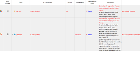

5 years agohow to handle this ip upgrade failure
Hi Dear Support/Expert,
I have a TI EVM called TSW14J56, it is a high speed data acquisition board with an Arria V FPGA, I am trying to update the IP to Arria 10 SOC Dev board.
I am using a Quar...
SyafieqS
4 years agoSun,
Pro IP to Std is not applicable. Thus, you might need to use directly the IP from STD.
