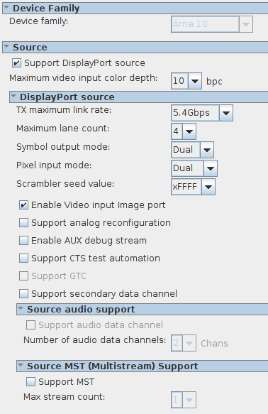

  • HI,
    You are right in the sense that BT.2020 should be enabled via VSC SDP but I don't see you enable "secondary data channel" in your Intel DP Tx IP.
    • This could be the problem as you are transferring secondary data packet (SDP) here
    Below is what I found out from DP rev1.4 spec
    1. Pre-requisite
    • Ensure DP sink EDID support 3D Stereo in-band signaling
      • Ensure DP sink enable “VSC_SDP_EXTENSION_FOR_COLORIMETRY_SUPPORTED”, DPCD address 0x2210h (bit 3 = 1)
      • Enable Intel DP Tx “secondary data channel”
    • Then to enable/configure BT.2020 support
      • DP Tx set MSA (MISC1, bit6 =1) to use VSC SDP
      • Configured YCbCr 422 BT.2020 setting via VSC SDP, payload data byte (DB16)
