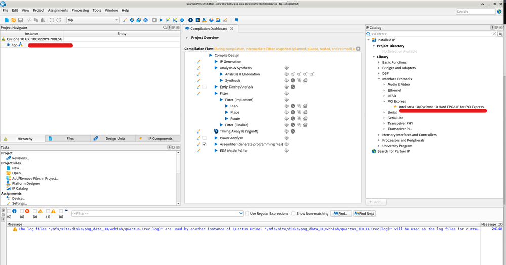

Minzhi, another method for you to get PCIe reference design is through Quartus IP catalog
you may refer to below step for cyclone10/arria 10 device
https://www.intel.com/content/www/us/en/docs/programmable/683647/18-0/generating-the-design-68524.html
Let me know if you still cannot get it.
Wincent_Intel
- MinzhiWang1 year ago
Hi wchiah,
You know, my object device is Cyclone 10 GX, and also we have Cycone 10 GX development kit in hands. So when we generate example design, the target dev-kit still is required to chose Arria 10's kit?
BTW, our Quartus Prime Pro version is 23.4
- Wincent_Altera1 year ago
Hi Minzhi,

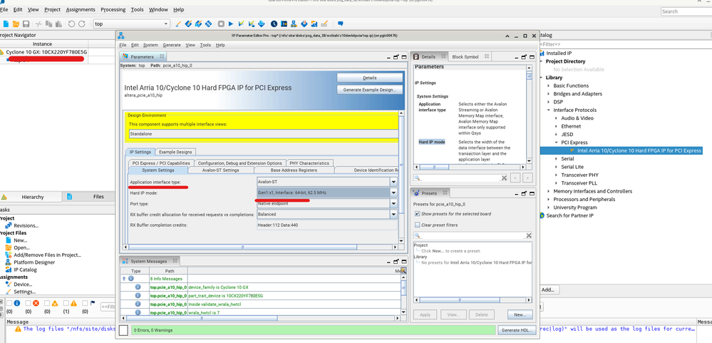

Yes, I am aware that your devkit is Cyclone 10. You may select Cyclone10 devkit when generate the design.Inside it , you can choose the interface type as AVST and HIP mode speed.
Let me know if you still unable to get it.
Regards,Wincent_Intel

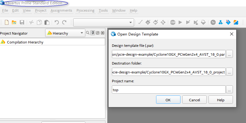

Yes, now I can get it. I also found that I can open .par file by using the command "Open Project" from Quarus "file" menu. However, I have to launch Quartus Prime Pro firstly, otherwise, when i double click .par file, i'll get following issue:
As above image shows, the Quartus Prime Standard will be launched automatically when i double click the .par file.
Do you know how to switch the default quartus.exe procedure from standard to pro in my computuer?
