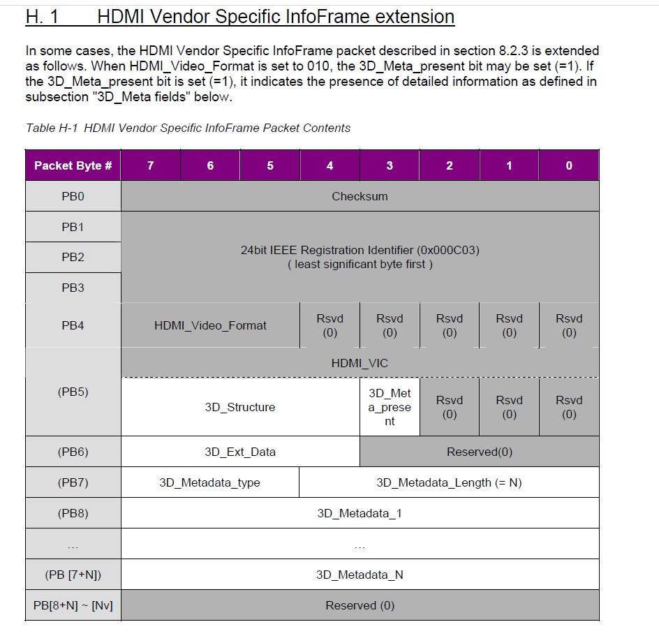

Does the Core support the 3D meta data extention (VSI extended frame - see below)?
- ZH_Intel
Hi Amildm,
Good day.
Regarding to your question, Intel do not support the 3D meta data extension. There is only 62 bits in VSI filed and no other signals to transfer 3D meta data in HDMI IP core.
Thank you.
ZH_Intel
