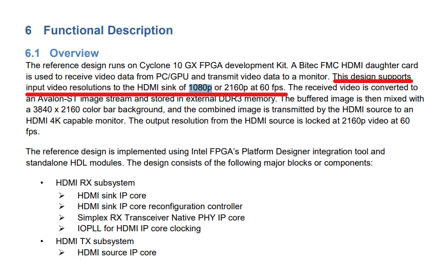

- Wincent_Altera
Hi ,
If you are considering Cyclone 10 family for 1080p.
You may get the design via our FPGA design store for early assessment.
https://www.intel.com/content/www/us/en/design-example/714562/intel-cyclone-10-gx-fpga-hdmi-4kp60-with-video-and-image-processing-pipeline-reference-design.html
Regards,Wincent_Intel
