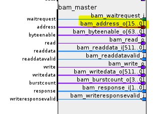

I tried the same and I only can see the 16bits on the address. These address bits are affected by the setting of "Address width of bursting master" of the PCIe IP. I believe the developer hack the IP and change the address width to 30 instead.
If you need, you can change this by modifying the g3x16_hbm2_avmm_bridge_512_0.ip file.
Search for Address width of Bursting Master and you can change the value to 30.
