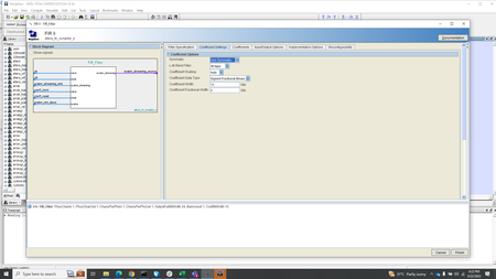

we want to use FIR filter IP block from intel on quartus lite prime with cyclone V E fpga in our design. So tried to test and simulate IP working on the model sim as well as on signal tap.

we using quartus prime lite 21.1, we have valid FIR 2 filter IP license . cyclone V E part we using is 5CEBA9U19C7.
yes its signed fractional binary format. we tried that only. same we tried on signal tap also same issue
