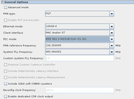

3 years agoEthernet 100g cant be placed at the location on Agilex 7 FPGA
Hello When synthesis design for AGIB027R31B1E1VAA that contains F-Tile Ethernet Intel FPGA on Intel Agilex ® 7 FPGA I-Series Transceiver-SoC Development Kit I got the next error: The specified bl...

3 years agoHi redst,
You can get the F tile Channel Placement Tool in link below, Section 7.1, pg 231, https://www.intel.com/content/www/us/en/docs/programmable/683872/23-1-4-4-0/f-tile-channel-placement-tool.html
