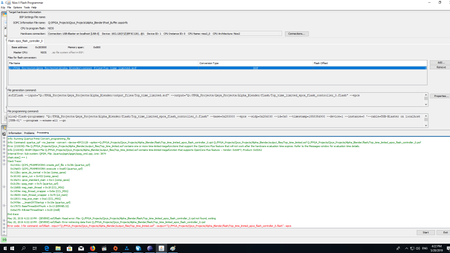

7 years agoEPCS64 and Nios II SBT, Error code: 3
Hey I am using DE2-115 board and I would like to flash my board through flash programmer inside Nios II SBT for eclipse, I followed the instructions provided in the flash programmer user guide and I...
