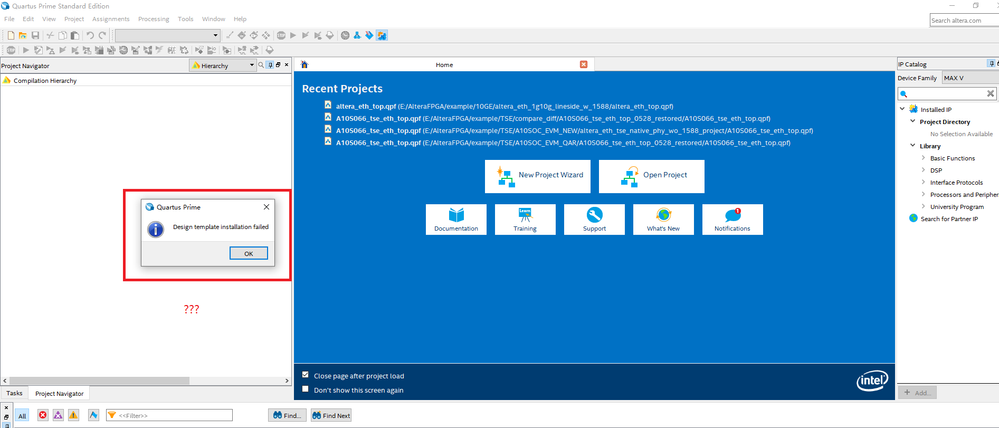

Maybe I don't make myself very clear in previous comment.
Yes the *par can be downloaded , but what I mean is " the *par cannot be opened successfully", it says "design template installation failed" !! I use "Quartus Prime 16.1 Standard Edition" .
As following pic. Thanks
- Deshi_Intel
Hi Jet,
Now I understand your problem. I can open the design.par file successfully from my Quartus v16.1
Looks like there is some issue with your Quartus design template. Have you tried to follow the instruction to launch and install design template as per the guideline in below reference design link
- https://fpgacloud.intel.com/devstore/platform/16.0.2/Standard/arria-10-scalable-10g-ethernet-macnative-phy-with-ieee1588v2-design/
I am not sure whether you need internet connection for the proper installation or not but feel free to try it out.
Let me know if you have try out everything and still face design template installation issue then I will consult Intel software team to look into your issue.
dlim
- JET60200
Contributor
Thanks a lot @Deshi, after follow your suggestion to install design template, my Quartus 16.1 can create example project successfuly. I'm building it now.
