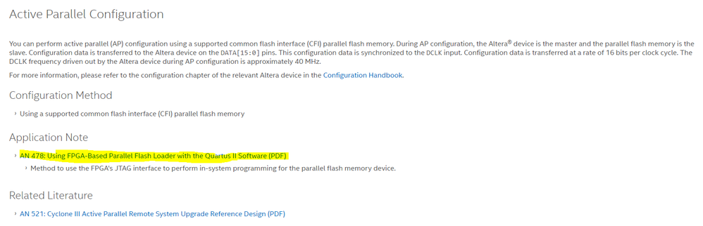

hey,
In the link about the Active-parallel, the PFL IP is mentioned (AN 478). So the PFL IP does support the Active-Parallel or I should do a state machine by myself to configure the flash?
thanks
- NurAiman_M_Intel
Apologize for the misunderstanding.
PFL IP do support Active parallel but only applicable to Cyclone 3 and 4 only. Active parallel supported common flash interface(CFI) parallel flash memory. Hence you may refer to AN478 for further information.
Thank you.
