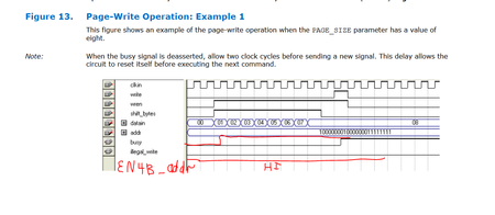

I am attempting to implement the ASMI Parallel IP on my Cyclone 10 GX. I am able to perform sector erases and reads just fine (I can erase everything and read back all FF's). However when I...

Responding to myself for the benefit of future readers:
Do not leave the pin high. Strobe en4b_addr once, possibly during your boot up process, and keep it low.
If you have en4b_addr HI when you attempt to perform a shift, the en4b_addr command appears to be set in preference over shift operations.
