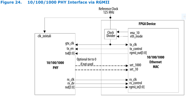

7 months agoCorrect way to configure the RGMII input and output pins on a MAX10 FPGA
Greetings ALTERA Expetrs, I am using an ALTERA Triple Speed Ethernet IP core configured n MAC only mode, which talks to a MARVELL 88E1111 PHY. Actually for this example i am using an ALTERA MAX10 10...
FvM
7 months agoHi Barry,
not sure why you're instantiating dedicated DDR IO. TSE IP in RGMII mode already interfaces to DDR RX and TX data.
Frank
