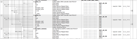

Hi Team, i am upgrading the design from 13.1 to 22.1. in my design i have ethernet ip , in 13.1 ethernet is handled SGDMA with OCM. In 22.1 SGDMA ip is available, but while generating bsp , it i...

i want to confirm that sgdma support is there or not.
why bsp is generating mSGDMA library files in firmware even FPGA qsys design contains sgdma ip (sopcinfo).
We faced this issue. after that only we moved to msgdma ip use.
Whether we are moving in right direction. Please confirm this.
