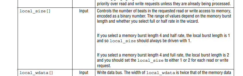

I set memory burst length = 8, and use half rate.
Can I set local_size = 4, 8, 16 or even higher?

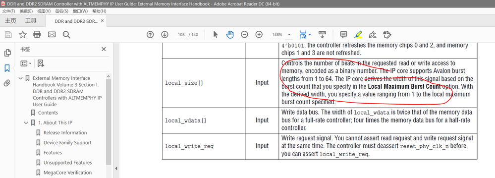

    But why?
    In user guide, the max = 64;
    when generate the ddr ip instance, local maxinum burstcount already set = 64.
  • AdzimZM_Altera's avatar
    AdzimZM_Altera
    I hope you are doing well.
    The DDR IP instance will be reflected by the IP setting.
    You have set the Local Maximum Burst Count = 64.
    Then the local_size width will be 6.
    But the memory burst length is set to 8 beats and you are running the controller with a half rate.
    So your local_size should be 2.
  • XIAOQ's avatar
    XIAOQ
    Thanks! The memory burst length can only be set 8 or 4. I am not sure what's the relation of memory burst length and local maxinum burst count? why can not set higher burst local_size?
    AdzimZM_Altera
    I don't have the exact reason on why you cannot set a higher local_size but I think it's the limitation on the controller side.
    So you have to follow the document for your configuration.
