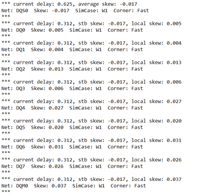

2 years agoBoard_skew_parameter_in_ddr3_controller
Hi Team, I have to add skew for dq, dqs and dqm signals for dddr3 from SI analysis report. The following image contains the report sample, how to configure the above skew setting in the be...

2 years agoHello,
You can use Board Skew Parameter Tool to do the calculation.
Here the guideline: https://community.intel.com/t5/FPGA-Wiki/Board-Skew-Parameter-Tool-Guide/ta-p/735276
Adzim
