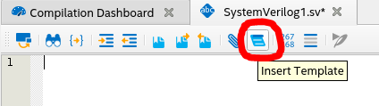

If you're looking for template, can go to Insert Template icon after creating new file see the image below.
