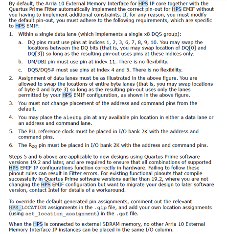

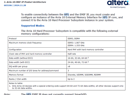

  • Hi
    I'm sorry for the delay in getting back as it has been awhile on this case and I'm just checking whether you have resolve the issue at your end?
    You're correct on this, the clock relationship between HPS and EMIF IP is handled automatically, just need to configure the memory settings in EMIF IP. Just some further information to connect the HPS to EMIF IP
    Once again sorry for the delay in getting back
    Kian

    Hi
    Kian
