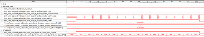

My issue is that, when I write for instance with a burstlength of 16, I have 16 "waitrequests" going high for 8 clock period @ 266MHz. Meaning I have a datarate 8 times slower : 266/8 with 256 bit bus on EMIF AMM side or 2133/8 with 32 bit bus on DDR4 side ! See the signaltap diagram below :
As you can see I perform 16 writes waiting each for the the waitrequest to go low in order to proceed with next write of the burst.

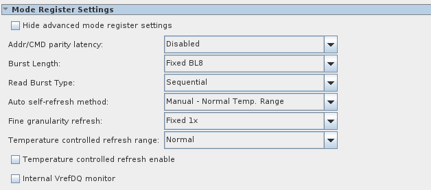

My wonder here, is that I am actually performing 16 burst writes with a burstlength of 8, so a total of 128 writes... Why do I that ? Because here is what I found in the EMIF advanced mode register settings :
We can cleary see that the burst length is set to "Fixed BL8" which I suppose means that I cannot change this length of 8 through the amm-burstlength. This explains why I would have a waitrequest of 8 clock period @ 266 MHz, this is just bursting the 8 writes during this time. Am I right ? I will check this of course, but I want to be sure that this is the intended write, and I don't understand why there is this confusing amm_burstlength while the burstlength is fixed and appears to not be editable.
