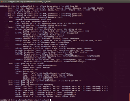

Hi, I get the "ERROR: Module altera_dma does not exist in /proc/modules." message every time I try to run install. It always fails on the altera_dma_load stage of the Makefile. If I manually edit altera_dma_load to assign a $major value that is not currently in use by any device listed in /proc/devices then the driver will load. However when I execute ./run I just get no response (i.e. I don't see a print out of the options). It just sits there doing nothing.
For AN829 I have been executing "sudo ./install arria10".
Any other suggestions or troubleshooting steps I can try?
