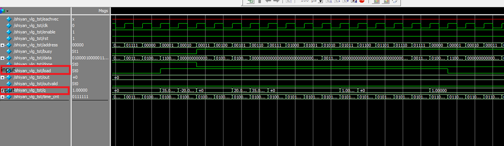

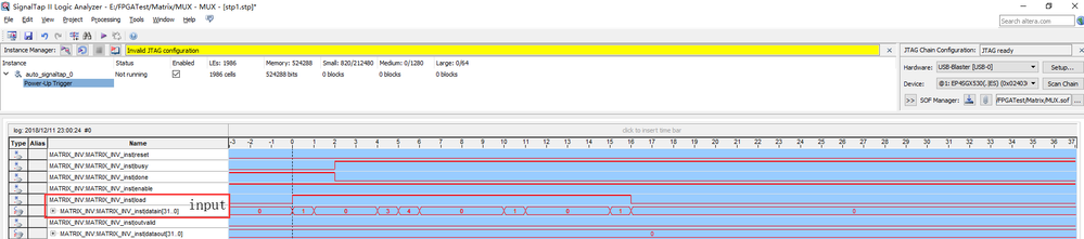

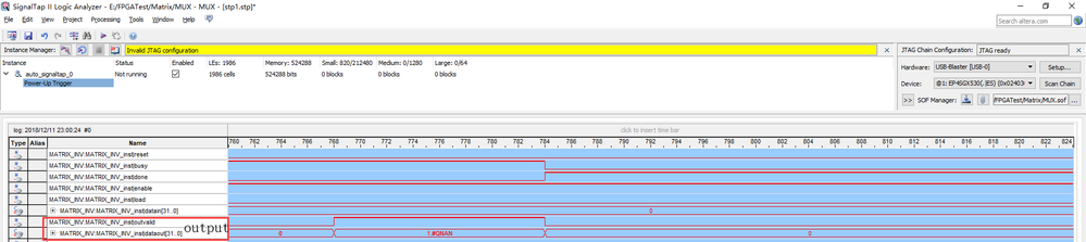

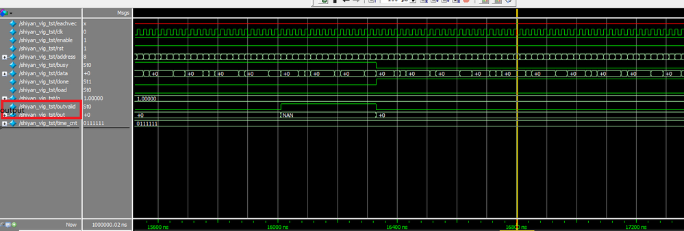

      Thanks for you reply. I tested two sets of data.
      The first set of data, the matrix that I put in is {1,0,0,0; 3,4,0,0; 0,0,1,0; 0,0,0,1}, ture inverse of this matrix is {1,0,0,0; -0.75,0.25,0,0; 0,0,1,0; 0,0,0,1}. BUT I got the wrong result is an abnormal number (NAN) in Modelsim simulation and in Signaltap Ⅱ. As picture 1,2,3,4 show.
      Second set of data, the matrix that I put in is {35,-20,0,0; 20,35,0,0; 0,0,1,0; 0,0,0,1}, ture inverse of this matrix is {0.021538,0.012308,0,0; -0.012308,0.021538,0,0; 0,0,1,0; 0,0,0,1}. BUT I got the wrong result is {0.0424242,-0.0242424,0,0; -0.0242424,0.0424242,0,0; 0,0,1,0; 0,0,0,1} in Modelsim simulation and in Signaltap Ⅱ. As picture 5,6,7,8 show.
      1. I use EP4SGX530C2 FPGA ,and Quartus 15.0
      2. The following pictures are in order 1,2,3...
