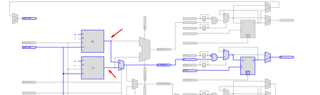

Hi
I implemented AND gate and sample it by FF :
Code :
wire b,c ;
reg a_sam;
always @(posedge clk)
a_sam <= b && c;
When the Fitter (finalize) step is finised I opened...
FvM
3 years agoHello,
the doubled LUT makes no sense at first sight. The effect is, that logic output is the same for both selector states. One would expect that the result can be achieved easier.
Which FPGA family are we seeing here?
- ymiler3 years ago
Contributor
Quartus Prime version 22.3
Device Family Stratix 10
Device 1SM21BHU2F53E2VG
