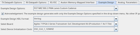

3 months agoAgilex 7 I F-Tile Direct PHY: example TB doesn't work
Hello community, I'm unable to run an example design for F-Tile on Agilex 7 I-Series device. I've tried following: 1. generate an example design using platform designer, 2. open the generat...

For the generated example designs, the scripts are already created. You just need to navigate to the right directory and source the scripts in the terminal. Make sure that the Quartus and the simulator are correctly loaded. For reference, go through the last portion of the following section in the user guide.
Ash_R_Altera
3 months agoHi,
