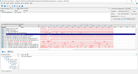

As shown in SigTap snapshot below, there is an extra pulse of app_nreset_status at sample 61. When this happens, the PCIe device does not enumerate correctly in Windows.
I also have a dump of raw ...

May I know which device family you are using? Could you share the stp file?

4 years agoDevice is Arria10 (10AS016C4U19E3SG)
.stp and a text dump of capture is attached.
