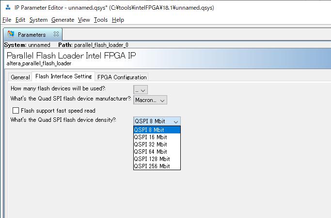

I want to use MT25QU02GCBB described in the Parallel Flash Loader User Guide, but there is no QSPI 2Gbit selection item in the setting screen of Parallel Flash Loader Intel FPGA IP.
Please tell me how to set.

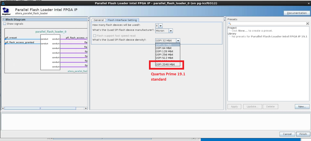

    • PFL IP with *Micron MT25Q 2Gbit flash is supported starting from Quartus Prime 19.1 Standard version and onwards.
    • Below is the screenshot for QSPI density choice option in Quartus Prime 19.1 Standard version:

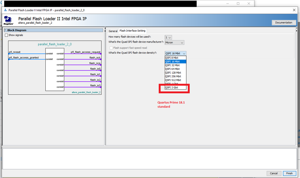

    • PFL II IP with *Micron MT25Q 2Gbit flash is supported starting from Quartus Prime 18.1 Standard version and onwards.
    • Below is the screenshot for QSPI density choice option in Quartus Prime 18.1 Standard version:
