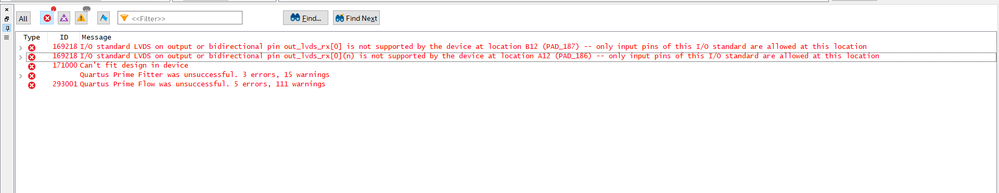

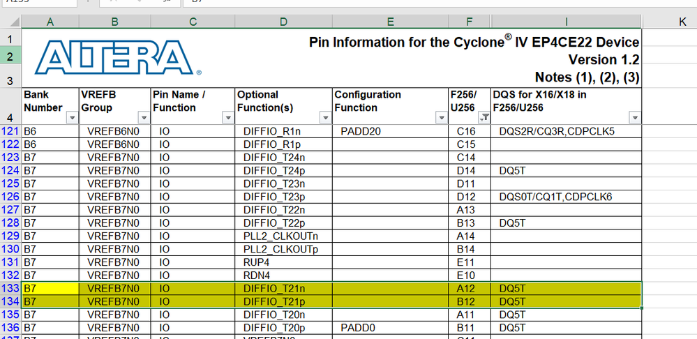

why this IO doesn't support output?
Device: EP4CE22U14A7N
In pin-out file, it looks support both input and output.
But when fitter by quartus, it reports error. why?

    Have you checked if you set the correct device?
